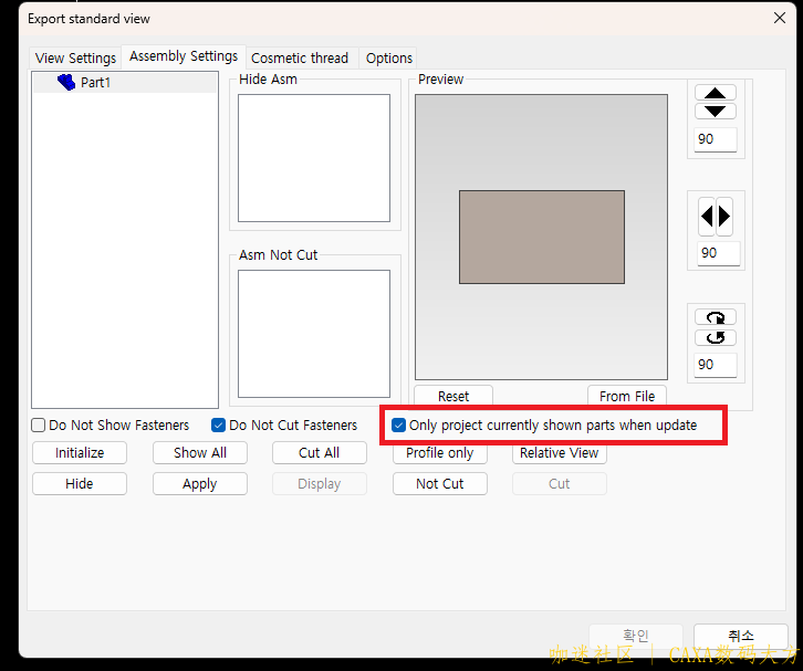

Hi, when I creating Views in CAXA, I usually Creating Views within turned-on this option. (For preventing some human errors... etc)
bandicam 2024-09-09 17-00-43-434.mp4 (4.77 MB, 下载次数: 1260)
That option will update all the parts/assemblies added after the view is created to the “Hidden part” state in the “Views Tree”, which is time consuming because you have to select each part in the “Views Tree” or create a new view if you need to modify it later to update it to the same state as the 3D drawing (parts added after the view is created are not hidden).
It would be very helpful for users to have a simple option to do this.
