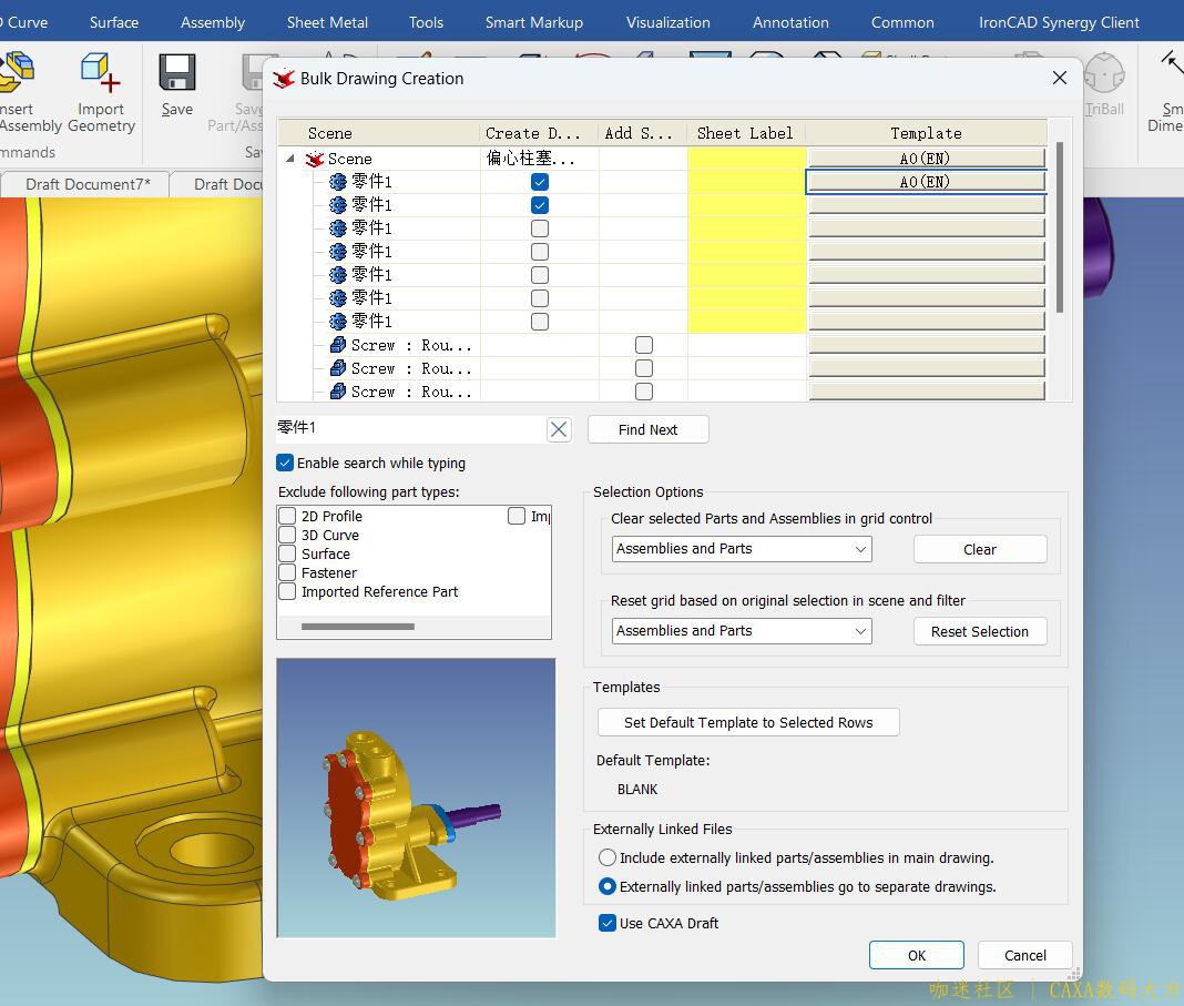

Hi,
In bulk drawing Creation tool, Externally linked parts/assemblies go to separate drawings with CAXA option does not go to separate drawings with CAXA Draft
Is it a bug?
Kim

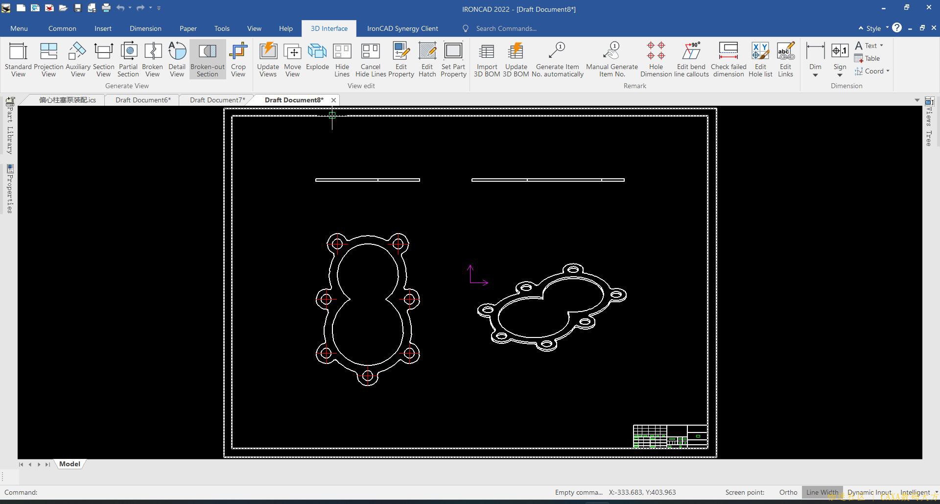

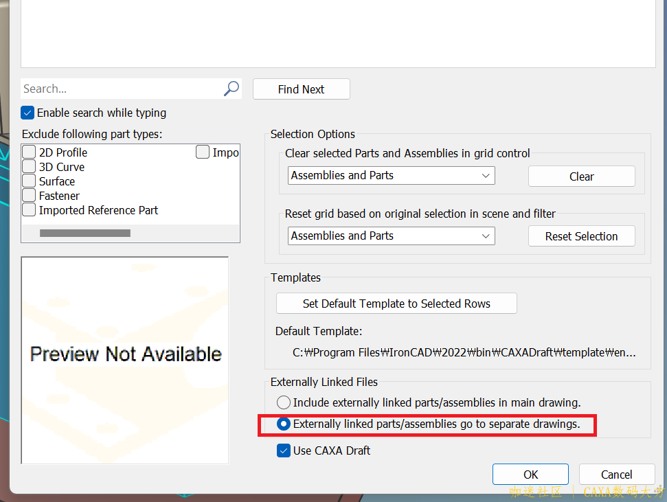

我这里使用IronCAD2022的版本是可以的,您可以检查一下设计环境等模板有没有设置?

 楼主| 发表于 2022-11-25 12:28:19 | 显示全部楼层
Hi,
I've tested some more and I've found Bulk Drawing Creation in Ribbon bar works well as your test,
Bulk Drawing Creation tool what appears after right click on the parts has different working.
我多测试了几次,发现蝴蝶结吧里大量图纸的制作非常适合你的测试。
用鼠标右键点击零件,出现的大量图纸制作工具的操作方式不同。
bandicam 2022-11-25 13-25-33-080.mp4 (4.41 MB, 下载次数: 2407)
Kim

 楼主| 发表于 2022-11-25 12:37:56 | 显示全部楼层
Hi,
I've tested some more, I've found something. Bulk Drawing Creation in Ribbon Bar working correctly like you.
Bulk Drawing Creation tool that appears after right clicking on the parts/assemblies is working differently.
你好,
我测试了更多,我发现了一些东西。功能区栏中的批量绘图创建工作正常,就像您一样。
右键单击零件/装配体后出现的批量绘图创建工具的工作方式不同。
bandicam 2022-11-25 13-25-33-080.mp4 (4.41 MB, 下载次数: 2367)
Kim
364
2274
2274
发表于 2022-12-14 09:39:51 | 显示全部楼层
收到您的反馈,确实有这样的问题,已经进行了内部反馈
