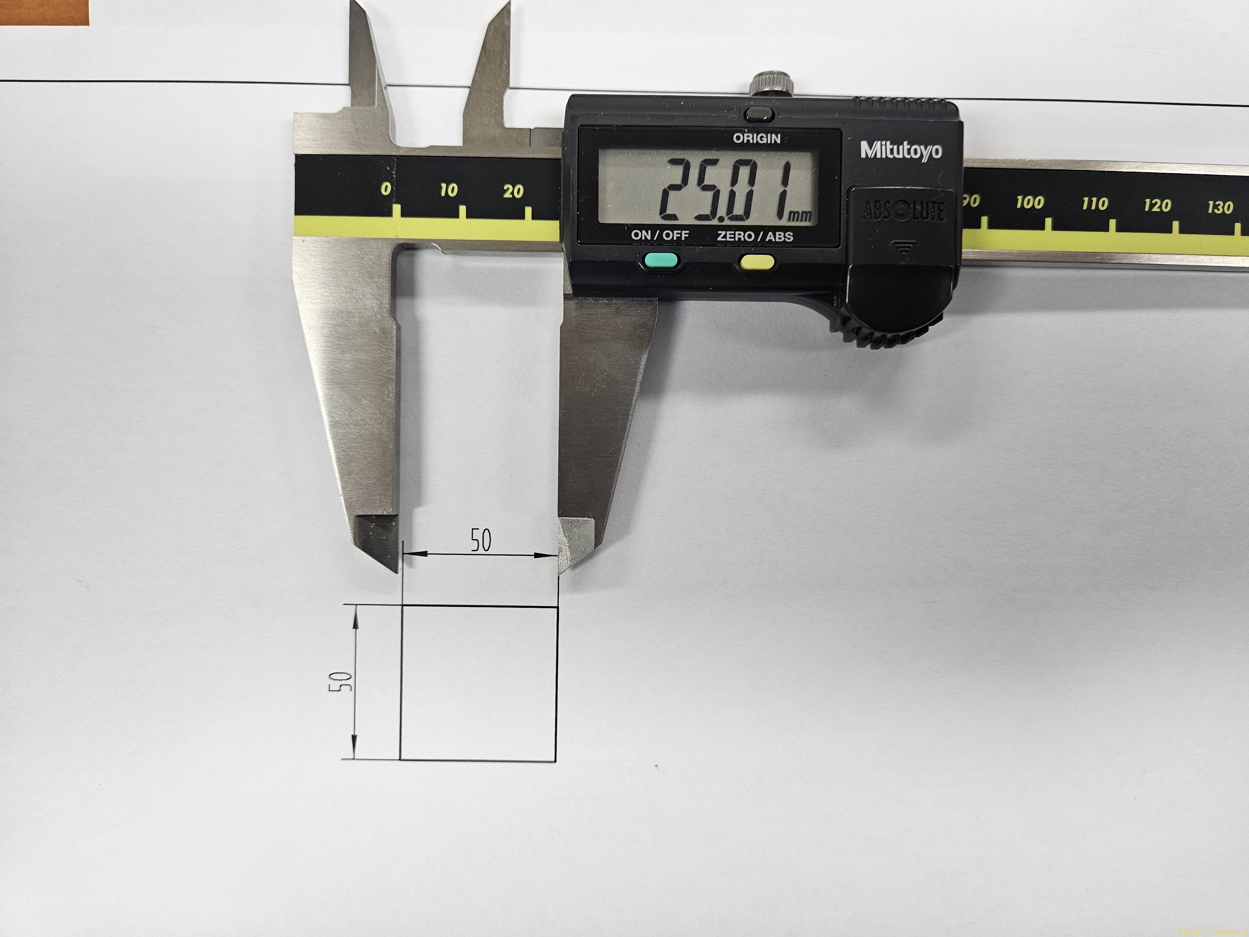

Hi all
It means it is not true "1:1 Scale" of the model. Thanks

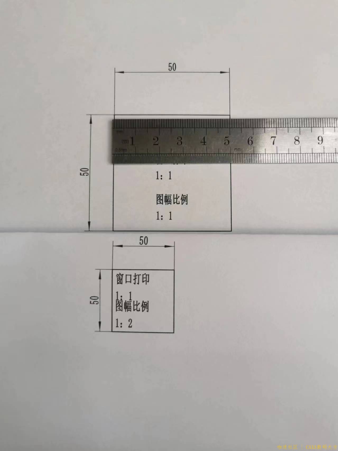

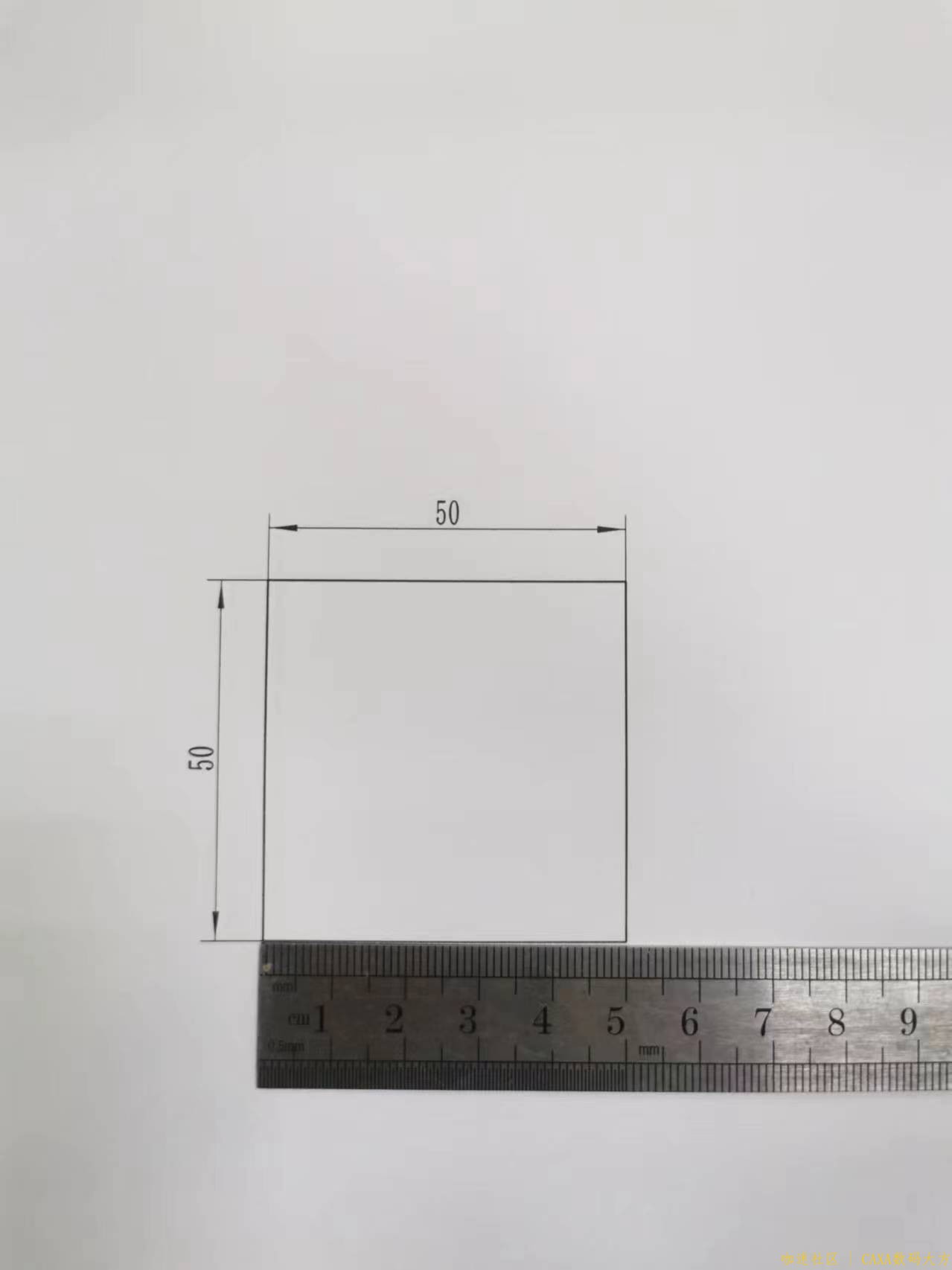

发表于 2024-3-27 10:51:47 | 显示全部楼层
Hi, it's normal here. Could you please upload your drawingsThe attachment shows the effect of 1:1 printing of the drawings

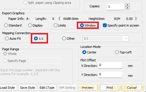

 楼主| 发表于 2024-3-27 19:03:50 | 显示全部楼层
Hi,
It was a simple 50x50 rectangle box.
Sorry I had forgotten to add the options I tested. "Window" options has this issue.
You can Try it with Export Graphics "Window" and 1:2 Paper Scale.
Within "Window option" and 1:1 fit should always be printed at 1:1 scale, regardless of the paper scale.
CAPTCHA is changed back to Chinese again, It's sad...

发表于 2024-3-28 10:17:09 | 显示全部楼层
Bertrand 发表于 2024-3-27 19:03
Hi,
The drawing above has a 1:1 scale and is printed in the window
The following drawings have a scale of 1:2 and are printed in the window
The mapping relationships are all 1:1
I think there's no problem

 楼主| 发表于 2024-3-28 15:35:23 | 显示全部楼层
Thanks,
As a engineer. I always need 1:1 scale even if the Paper scale is 1:2 or 1:3 or 1:4.
The 1:1 for window option in the plot should only be 1:1 for the model. Perhaps there is no one who is the engineer wants to print 1:1 with the window option and have 50mm print out as 25mm, because 1:1 printing for paper size is already possible with other options, but 1:1 printing for models with different paper scales is not currently possible in CAXA unless you check the paper scale and zoom in to 2:1 if it's at 1:2 scale and print it at 2:1 scale <- this method could occurs the human error.
I currently have to use another CAD program if I need 1:1 printing to avoid any mistakes, which is a waste of workflow.
So this should be an enhancement request, not a bug.
