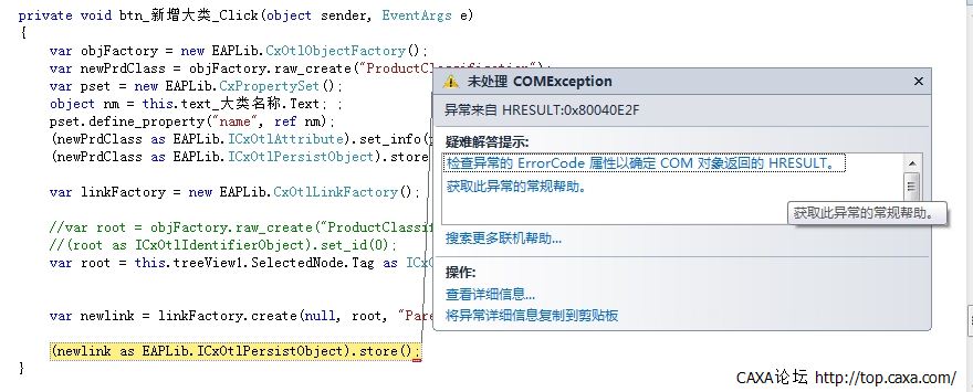

协同管理二次开发求助。每次为产品大类加子产品大类时,保存函数异常,但是子大类能加入进去;
20
20
发表于 2014-1-14 11:45:28 | 显示全部楼层 |阅读模式
<br> 82N``VJZ]OOESMZUQM7K.jpg private void btn_新增大类_Click(object sender, EventArgs e)
            var objFactory = new EAPLib.CxOtlObjectFactory();
            var newPrdClass = objFactory.raw_create("ProductClassification");
            var pset = new EAPLib.CxPropertySet();
            object nm = this.text_大类名称.Text; ;
            pset.define_property("name", ref nm);
            (newPrdClass as EAPLib.ICxOtlAttribute).set_info(pset);
            (newPrdClass as EAPLib.ICxOtlPersistObject).store();
            var linkFactory = new EAPLib.CxOtlLinkFactory();
            //var root = objFactory.raw_create("ProductClassification");
            //(root as ICxOtlIdentifierObject).set_id(0);
            var root = this.treeView1.SelectedNode.Tag as ICxOtlObject;
            var newlink = linkFactory.create(null, root, "ParentProductClass", newPrdClass, "ChildProductClass");
            (newlink as EAPLib.ICxOtlPersistObject).store();
游客
发表于 2014-1-15 17:37:34 | 显示全部楼层
最后一句(newlink as EAPLib.ICxOtlPersistObject).store();不需要,因为在前一句 linkFactory.create中已经将newlink创建并保存了。
